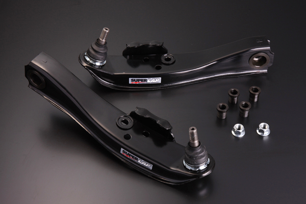

    So, I'm quickly realizing that to achieve the desired ride height up front the "Third Arm" will need to be shortened. For those wondering what the hell I'm talking about here's a picture:
    Now, I know there are several companies in Japan that sell these already shortened and ready to bolt on. However, shortening it is pretty straight forward. So has anyone done this at this point? If so to save some trial and error how much did you shorten it? If not I'll get and extra set and post the process and results. If you have any ideas or input feel free to add to the discussion!
    I'll be adding an adjustable upper control arm while I'm at it.

    For the GS/Aristo one company in Japan sells 40mm shorter knuckles, so I had my local cnc shop cut 38mm of mine and they even strengthened it with 10mm steel plates two sides when they welded it back together.
    This pic show the seems before I cleaned it up:
    I shortened mine because my UCA's were maxed out, and I couldn't get any lower with the 20" f/wheels. Plus this "should" correct my UCA angles so the ride should be better, and got rid of UCA-bang
    I don't see any reason why you should send your steering knuckles other side of the globe for this. As any reputable metal place could easily do this mod under quarter of the price the Jap shops ask... For my arms they said it took 3hours and ended up paying 120€. Not bad in my mind.

    my body/suspension shop cuts teeth into the knuckle for added safety so it doesn't move out of place. Then they weld it back together

    what do you hope to achieve by shortening the arm?
    i've had my q pretty much on the ground and didn't have clearance issues like a lot of lexus. the other benefit would be geometry correction. cutting that link will not make the car any lower.

    It will allow you to DRIVE lower. At the moment, the upper control arm hits the shock tower under compression when driving at pretty low heights. This will eliminate that. Sure, I can park low as shit, anyone on bags can do that but whats the point if it's not drivable at or near that height? This is what I'm trying to achieve. I'm actually considering switching back to coilovers, but haven't made a final decision yet. We'll see once this arm is shortened how it rides at the height I need it to be at for the fenders.
    There are a lot of clearence issues on the G50 when you start driving at silly low heights (IE tucking wheel on the stock front fender), most are easily solved in the rear (mini tub), but the front has it's limitations in stock form.

    For reference:
    This is what the control arm looks like on the garage freedom G50:
    And this is the ride height:
    At a similar ride height on a stock arm the upper control arm is essentially resting on the shock tower.
